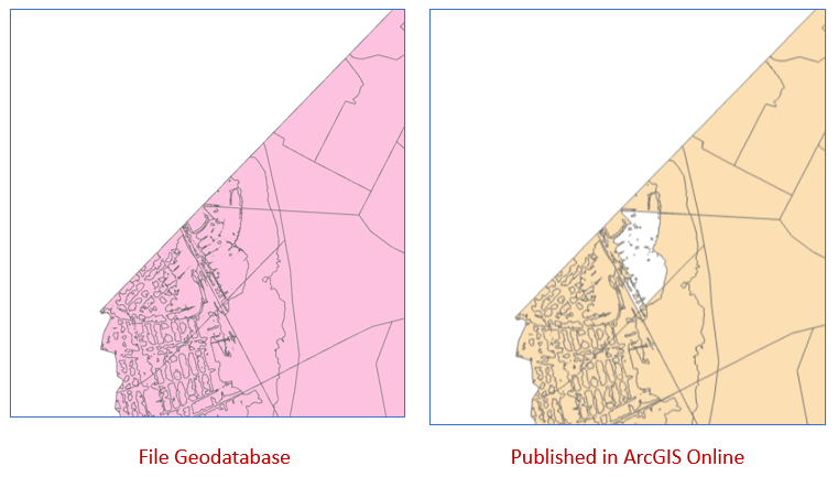

Hello, everyone!
Has anyone encountered an issue with missing some polygons of layers published in ArcGIS Online?
Here's the scenario:
Left Side: This is the original data stored in file geodatabase.
Right Side: This is the data published in ArcGIS Online.
Notice that after publishing the layer in ArcGIS Online, some polygons are missing. Before we publish the data, Check Geometry and Repair Geometry were performed. We have also tried overwriting and/or republishing the layer, but displayed the same result.
I appreciate any help or hints regarding this concern. Thank you very much.

Yes, I forgot to mention that the layer is visible in the Map Viewer/Map Viewer Classic in ArcGIS Online. However, when tried to view the published layer in ArcGIS Pro using the Portal tab, it has a missing polygon (please see screenshot). I am using ArcGIS Pro v.2.9.5.
