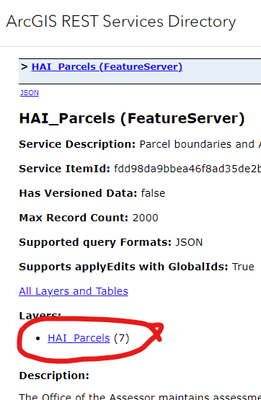

HollyTorpey_LSA
@Paco wrote:
Yes.  I am opening the specific Hosted Feature Layer in AGOL(using 'View' URL on the Overview page.   which gets me to the ArcGIS REST Services Directory,   and clicking on "Admin" in the upper right, and clicking on "Update Definition" at the bottom.
searching for and updating "maxRecordCount" and "lastEditDate"(10,000 and null) and clicking on "Update Service Defintion".
But after you click 'View', are you clicking on the layer name before clicking 'Admin'?
- Holly
Paco
Holly!  I actually was going to post a conclusion to my question earlier today!  and THIS was the issue.  thanks for posting.  I was not going far enough into the Service and choosing the specific Layer.  I didn't think I needed to because I only had One Layer per Service,  but I did.
so,  click Service URL,  CHOOSE LAYER,  Admin, and alter the field numbers.  even if there is only One Layer in the Service.
Thank you everyone for your input.   moving forward now!
