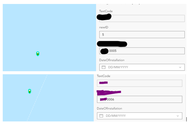

I have a web form that calculates an incremental ID and then concatenates it to form a refNumber.
It works fine until you decide to update the point: let's say the position is incorrect and you need to move it.
this is the code and below are the results: the number should stay the same as it is the same point:

create a point with ID 5 and then moved it becomes 6

Think you just need to check the $editcontext.editType.  If "INSERT", calculate ID, if "UPDATE", just move point without calculating.

PanGIS
Thank you @RhettZufelt .
It worked 😊
