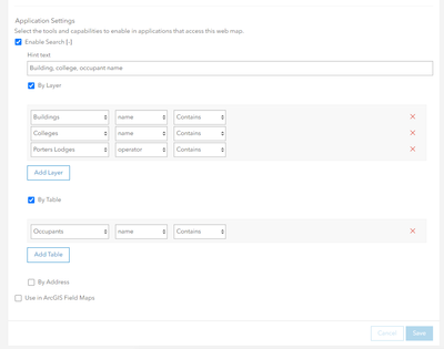

I have a hosted feature layer view that contains three layers and three related tables.  I've created a web map from this hosted feature layer and configured the Search options on the web map (settings tab) to do a contains search against the relevant fields of each of the map layers and one of the related tables:

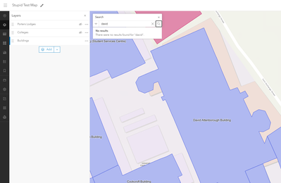

However, in the map, the search function doesn't seem to work.  The screen grab below shows the Buildings layer turned on and labelled with the 'name' attribute.  There is a building called the 'David Attenborough Building', yet searching for 'david' or 'attenborough' doesn't return any results:

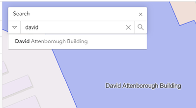

Now when I search in the map against the 'Building' layer for 'david' it does indeed find the David Attenborough Building:
Furthermore, I'm able to use the % symbol as a wildcard so searching for '%atten' also finds the David Attenborough Building:

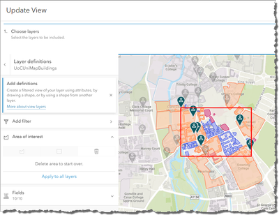

I then edited this new View to set an Area of interest so that only a small area of the dataset is exposed in the View (as this is how my original View is configured) and applied this area of interest to all layers using the Apply to all layers button:

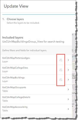

I think the reason the search still works fine against the related table is because the related tables are not affected by the 'Area of interest' setting in the View, as shown by the absence of the filter button against the related tables in the Update View window for the three related tables:
