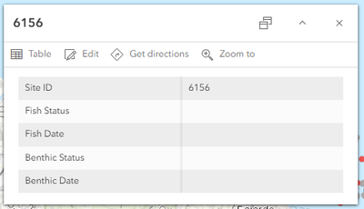

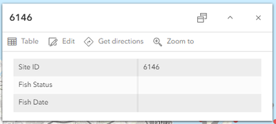

In this example I am testing whether a feature has the attribute "Fish and Benthic" (line 14). This field has a domain, so I have to get the Domain Name ( line 12). If the feature does have that attribute, I want the display to contain the five fields in the line 16. Otherwise, it will contain the three fields in line 22.
var fields = Schema($feature).fields;
var attributes = {};
var fieldInfos = [];
function fieldTest(fieldList, fieldName, fieldAlias) {
  if (Includes(fieldList, fieldAlias)) {
    attributes[fieldalias] = $feature[fieldName];
    Push(fieldInfos, { fieldName: fieldAlias });
var code = DomainName($feature, "Survey");
for (var i in fields) {
  if (code == "Fish and Benthic")
    fieldTest(
      ["Site ID", "Fish Status", "Fish Date", "Benthic Status", "Benthic Date"], //the list of fields you'd like if the feature has this attribute
      fields[i].name,
      fields[i].Alias
  else
    fieldTest(
      ["Site ID", "Fish Status", "Fish Date"], //the list of fields you'd like if the feature doesn't have that attribute
      fields[i].name,
      fields[i].alias
return { type: "fields", fieldInfos: fieldInfos, attributes: attributes };
 These are what the two popups look like

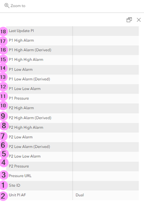

Thanks for reply! I tried your code and was able to show two separate popups by data like your sample. But the data don't show up... And the field orders are not what I want.
I'm using Uni PI AF for the condition, and if it's "Single", then this popup without P2 show up, and other than single, this popup show up. So, the single and dual is the only data show up nothing else. And the number in the pink circle is the order I want to see in the table. Attached the code I used.
