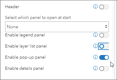

As an option, if you are primarily interested in a docked pop-up, Sidebar and Minimalist are two Instant Apps that allow configuring the pop-up information to appear in a side panel.

BernSzukalski
Esri Frequent Contributor
