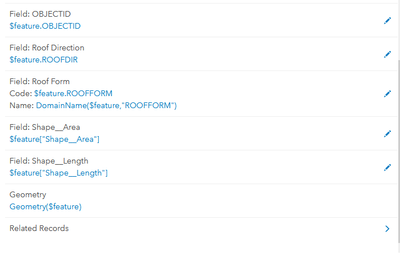

In case you don't know the relationship name off hand, you can find it in the expression builder at the bottom of the fields list:
Click "Related Records" and you can see the relationship there. Clicking the blue function will insert it into your expression.
The output of this FeatureSet function is equivalent to pulling in the featureset by name and then filtering it, but going through the relationship class, it performs a bit more efficiently.

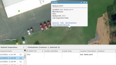

 Here is the pop-up that is shown when I select this hydrant, the table along the bottom suggests that this hydrant does have a related inspection affiliated with it.

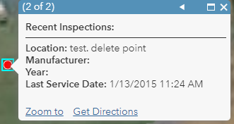

For reference, here is the dialogue box from the "recent hydrant inspections" layer on the same hydrant where the last service date is directly saved, this layer was created by the "Join Features" analysis tool
