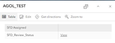

I created a feature class in Arc Pro and published it in AGOL for our surveyors to show the locations of their monuments and have the points link to the recorded survey document in our Laserfiche database online.

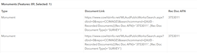

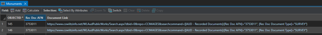

Here is what the table looks like in Arc Pro, note that in Arc Pro it is a hyperlink and if I click Ctrl and click on the link it will open in my web browser.

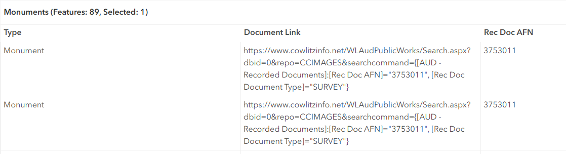

When I published the feature class online and opened it in Map Viewer it no longer shows up as a hyperlink:
If I copy and paste the link into my browser it will take me to the correct document.
Note that in the link below the only thing that will change will be the Rec Doc AFN number and that number is stored in my attribute table:
https://www.cowlitzinfo.net/WLAudPublicWorks/Search.aspx?dbid=0&repo=CCIMAGES&searchcommand={[AUD - Recorded Documents]:[Rec Doc AFN]="3753011", [Rec Doc Document Type]="SURVEY"}

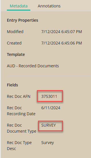

In this example when I paste this link in my browser it finds the correct document but the resulting link changes to a random id number that is assigned to the document by laserfiche:
https://www.cowlitzinfo.net/WLAudPublicWorks/DocView.aspx?id=31904090&dbid=0&repo=CCIMAGES&searchid=...
The metadata for the survey shows the search criteria that is used, which is how I was able to create the link that I stored in my attribute table.

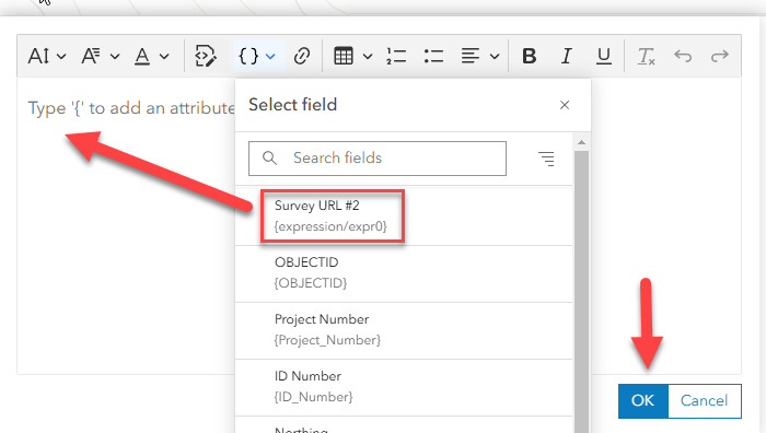

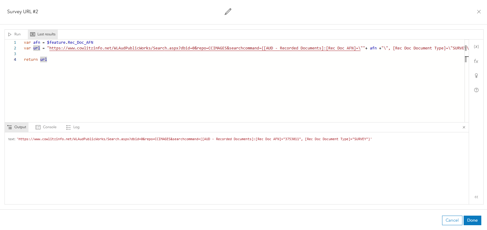

Attempt 1:

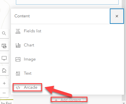

First I tried clicking Add content Arcade, but no matter what I added it didn't show up in the pop up window:
Next I tried clicking Options, Attribute Expressions, Add Expression and then I was able to see the link I was working on:
When I click Run with the following code, if I copy and paste the output into my web browser it goes to the correct document.
var afn = $feature.Rec_Doc_AFN
var url = "https://www.cowlitzinfo.net/WLAudPublicWorks/Search.aspx?dbid=0&repo=CCIMAGES&searchcommand={[AUD - Recorded Documents]:[Rec Doc AFN]=\""+ afn +"\", [Rec Doc Document Type]=\"SURVEY\"}"
return url
Output Link:
text: 'https://www.cowlitzinfo.net/WLAudPublicWorks/Search.aspx?dbid=0&repo=CCIMAGES&searchcommand={[AUD - Recorded Documents]:[Rec Doc AFN]="3753011", [Rec Doc Document Type]="SURVEY"}'
But when I click Done, and click on the link in the pop-up window it goes to this link instead which says " No results have been returned yet".
 (Note that I added a text box with it linked to the expression to get it to show up in the pop-up window)

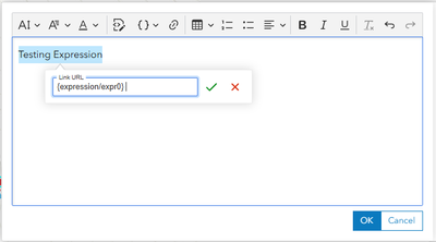

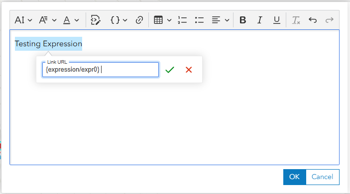

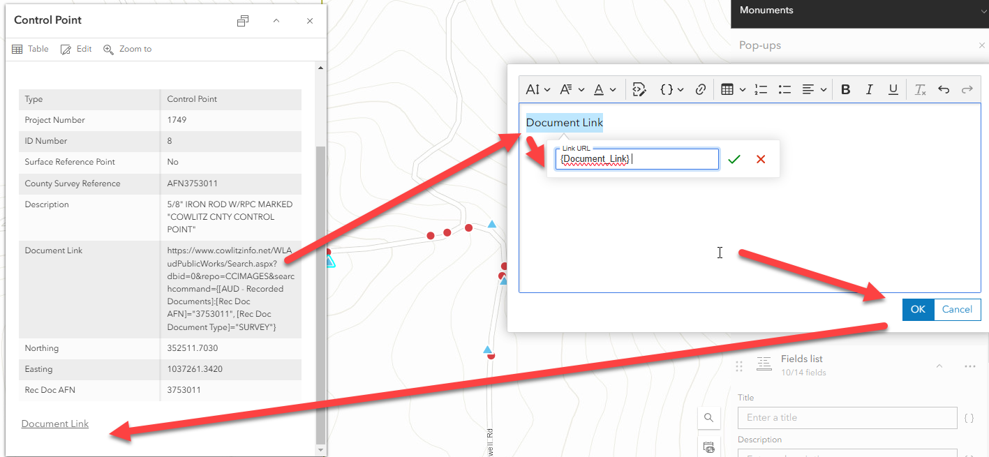

Attempt 2:
Next I tried creating a text box and using it to turn the column in my attribute table that contains the full document link into a hyperlink. But that didn't work either.

Alternate Solution:
There are several safe options for generating a URL for pop-ups that include a specific value or have a value change dynamically. 1. Use the link tool in the text editor to create the link. The link can be static or dynamic, e.g. baseURL + {field_name}. The curly braces in this case are not part of the URL, they're ArcGIS's way of referencing a field or attribute expression so that values from your dataset can be dynamically inserted. 2. Use Arcade to generate the URL. Either using attribute expressions or Arcade elements. For example, return 'baseURL' + $feature.ID OR leverage the text functions Right() and EncodeURL() to extract and encode the value enclosed in curly braces and then add that to the base URL.
