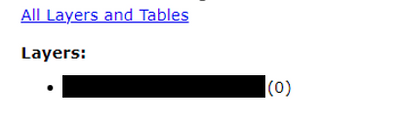

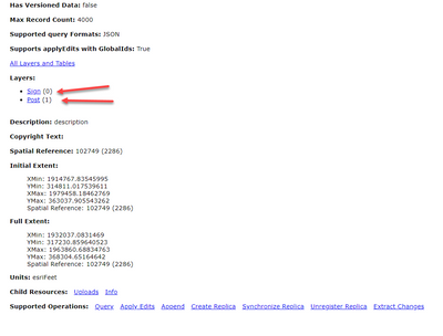

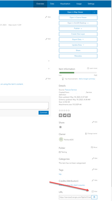

Probably the easiest way is to click the view URL in the item details overview page:
Any you will see the id number for each layer in that service:

Thanks! for your answer... i can see now the ID ... ID is 0 in AOL and ID is 0 in Arcgis Pro.. but did not work  and  now i'll try to match the los alphanumeric IDs and see if this help me!!
EmersonCardenasSachica
Hi... thanks to all for the answers in this question...  I have learned so much and now i know my problem...  in arcgis pro i have a Layer with Layer ID (0) ... but in Arcgis Online i have 12 maps showing me Layer ID (0) but two maps show me Layer ID (3) ... if I change the layer ID in arcgis Pro to ID (3) and overwrite the layer in AOL it correct the two layers but show error in the others 12 maps ...  the question is.... ¿can I change in AOL the layer ID form (3) to (0) to correct this two maps? ... or i have to rebuild this two maps (colors, simbology, labels, etc)? thanks for your help
