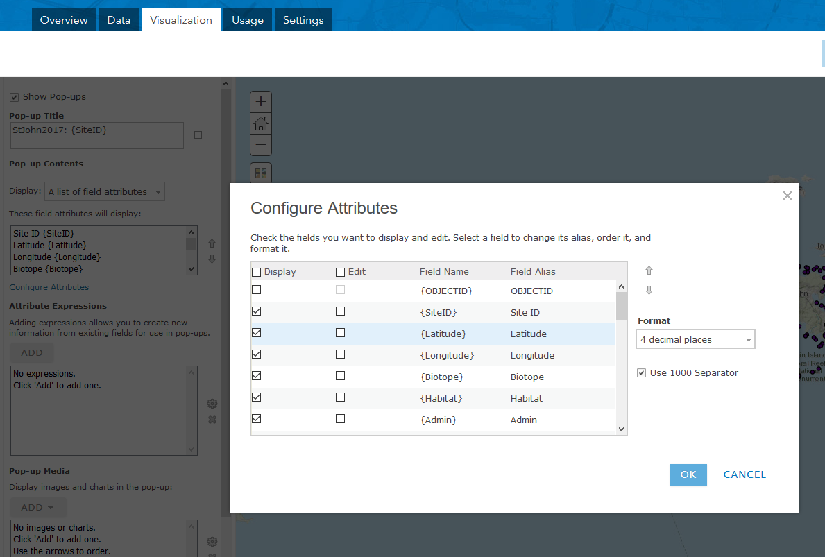

How do I get more decimal places to show up in the lat/long fields in the hosted feature class layer attribute table?

If I double click on the cell containg the values, I can see more decimal places carried out. Is there a setting?
KenBuja
MVP Esteemed Contributor
Click on the Visualization tab of the service and click the Configure Pop-up button. In the Pop-up Contents section, click Configure Attributes, then click on the field. Select the number of decimal places you want to show.
Click OK on that dialog box, OK on the panel, and Save Layer.
SiranErysian2
Perfect! It worked. I love this, I don't have to bug ESRI for a simple question. Thanks so much!!
SiranErysian2
OH wait! It didn't appear on the web map. I refreshed the page. Isn't the feature layer and web map supposed to be linked?

SiranErysian2
Thanks I figure it out, I did the same to the feature layer in the web map and it took.
