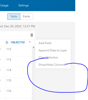

When I check the feature layer 'Data' tab, several fields are not visible, including some that are used in filters and labelling. I am trying to make them visible, but it's not sticking. I wonder if this has something to do with it. When I set the ones I need to be visible, it doesn't stick. When I refresh the screen, it reverts to being not visible by default.
