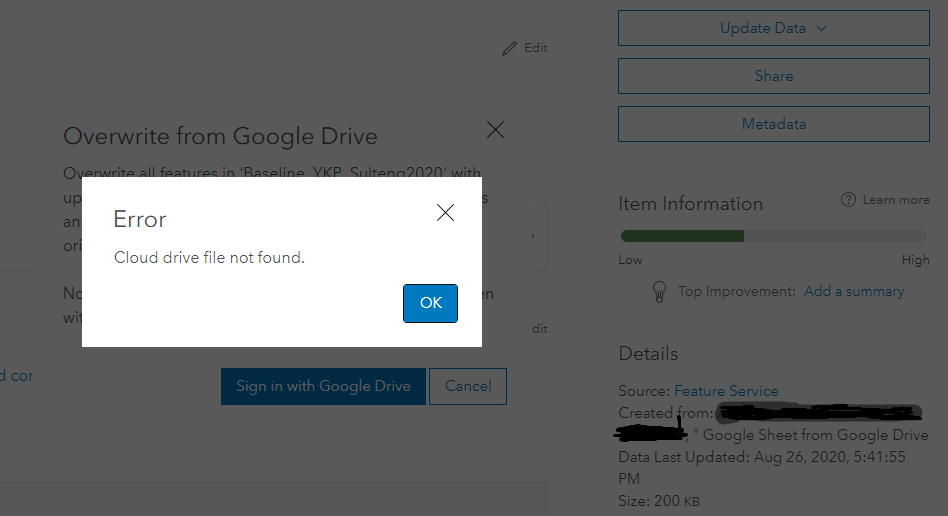

AdiKurniawan
Hi, I just the similar problem when suddenly I cannot update the entire data through spreadsheet data connection due to cloud drive file could not be found. As Peter Klingman‌ says that there is a bug and the bug has been fixed, is there any step that I should follow to fix it. I've try to lookig for in https://community.esri.com/external-link.jspa?url=https%3A%2F%2Fsupport.esri.com%2Fen%2Fbugs%2Fnimbu... but I did not find any clear information to fix it.

AdiKurniawan
Hi Peter Klingman‌ thank you for your response. This issue was not occurred when I create a new feature layer with spreadsheet. The problem just occurred when I try to update the data a couple days ago. Since I created this feature until last week, It can run smoothly and I didn't face any problem to update the data.
So, the problem suddenly occurred on the last week the I get the notification if the cloud drive file could note be found.
Should I create a new ticket for this issue or we still can communicate through this ticket?
