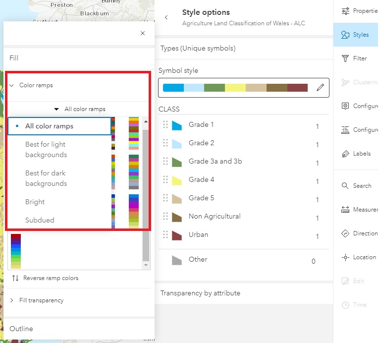

When i use the Map Viewer Beta it only shows 4 options (and makes no reference to anything colorblind friendly):
colorblind friendly ramps
I appreciate this could be 'Beta' related issue - but just wanted to know if anyone had any salient advice for me?

It seems that Colorblind friendly ramps are only available for numeric data fields e.g. Short Integer and Double but not String
Also Colorblind friendly ramps are only available when you select a Drawing Style = Counts & Amounts (Color).

Hey Oliver,
I did a quick test with my own ArcGIS Online account and I was able to find a filter for colorblind friendly ramps.  This may sound very redundant but after selecting the "All Color Ramps" are you able to scroll down further?  When I do so I'm able to find that colorblind filter and I see quite a few options appear.
