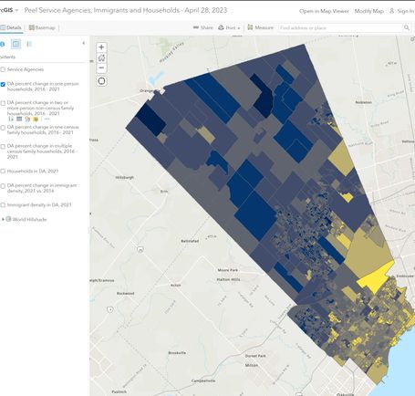

I created a web map recently (https://utoronto.maps.arcgis.com/apps/mapviewer/index.html?webmap=9716d257b59347ceb72c4708fcdfce7b). However, the following layers do not display on the map when I unhide them, even if all other layers are turned off: "DA percent change in one person households, 2016 - 2021" and "DA percent change in immigrant density, 2021 vs. 2016".
In the ArcGIS Pro projec this web map came from, these layers appear just fine.

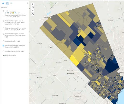

The layers are visible in Map Viewer Classic: da.JPGone.JPG

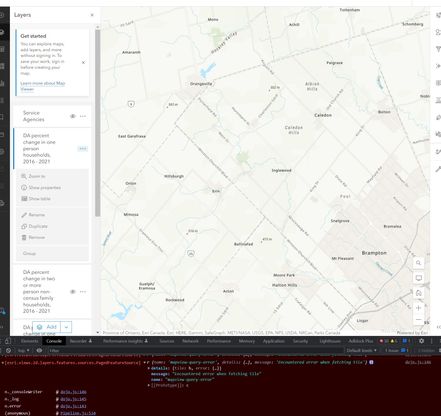

but not the new Map Viewer:
You can see in the console there is an error message querying the tile. Not much on this error specifically.
I thought it might be tied to symbology, but changing it to location only didn't help.
Other users have indicated general issues between map viewer classic and map viewer are tied to projection but it looks like Web Mercator. But possibly it's a geometry issue?
If you copy/paste the network request it shows a 400 error with bad parameters.
https://services1.arcgis.com/9NvE8jKNWWlDGsUJ/arcgis/rest/services/Peel_Service_Agencies__Immigrants...
  "error" :
    "code" : 400,
    "message" : "",
    "details" : [
      "Unable to perform query. Please check your parameters."
