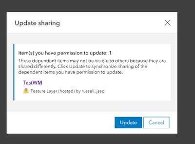

I cant seem to reproduce this
- Create map in MVC
- Open in NMV
- Add Private layer to existing map in NMV
- Save Map
- Click Share pick the sharing options or leave it unchanged to the current level and click save
- See Update Sharing notification.
LMK if you are doing something different.
