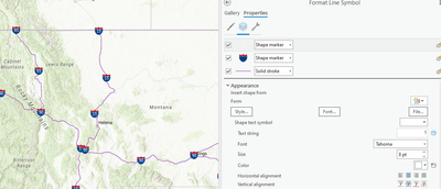

RodneyParker
See attached pic from Pro.
RussRoberts
Esri Notable Contributor
To do highway shields the labeling should be done within the symbol.  When you author the symbol the structure might look like this with a marker symbol using a text symbol and symbol property connection to the field.
