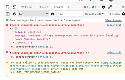

Sometimes I use the web browser's developer tools to dig deeper for errors.  (See example below)
  • Every browser flavor has these.  In your browser, usually, you go into your settings, and there will be a menu item for tools or developer tools.
  • If you go into a Console view, you can usually see what is throwing errors when the page is loading, to at least give you some hints as to what is going on.
  • Here is an example of what I found when I loaded one of my maps created in Classic Map Viewer into the new Map Viewer - I found out exactly what the problem was with one layer's labeling situation when I used the Console view in the Edge DevTools (Edge Browser), and opened up the error to see the details.  It says that the Renderer of type heatmap does not currently support labeling.  Ok, so I know that this is causing one issue.  I have to open up the error message, where it has a right pointing arrow with an f to see what is going on in more detail in the error message.
