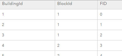

If you just need the shortest distance and have a feature class like this:
Then you can get the distance to the closest building in the same block like this:

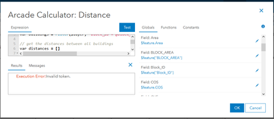

User1RECS
Hello Mr @JohannesLindner ,
I'm sorry but it still doesn't work
JohannesLindner
MVP Alum
Hmmm... No idea what the error message means. This is probably something specific to AGOL (I tested in Pro) or to your data.
Is your data publicly available so I could take a look?
