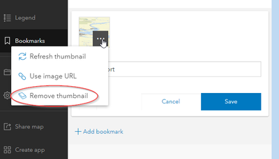

Late to the party but we are still on ArcGIS Enterprise 10.9.1. The issue is resolved as mentioned above  by @BryndaHatch by saving in Map Viewer Classic.
I was also able to resolve the issue by simply removing the thumbnails in your (New) Map Viewer and saving. No need to open map in Classic and save.
