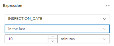

I've had an issue that I've run into periodically when using pre-existing layer sets in my maps.
My mapping tends to be focused only on short term data, so I often use the filtering in the layer to restrict the data to the last 24 - 72 hours.  Some layers have a huge amount of data that extends quite far back and my maps are meant for current operations, so restricting it to the last 24 hours is important.
Often, there isn't an issue with adding the filter restricting it to the last 24 hours, 2 days, 1 week, etc, but sometimes the layers I find are missing the option to filter "in the last" x hours/days/etc and instead are limited to filtering only to on/before/after specific dates.
Can anyone explain why that is?  Even if both use a date/time group, they for some reason don't give me the same filter options.
Filter without option in relation to current time
Filter with the option in relation to current time
Is there a fix for this?
I've attached (or tried to, with our network) two examples of my layer options.

We only show options for in the last x for hosted layers bc these relative time queries are supported there.
