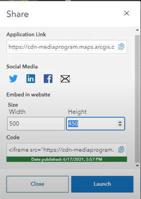

If you are asking how to embed the map into another webpage, you can follow these steps:
Here is a video that will walk you through the steps and provide a visual guide to help you embed the map into your webpage.

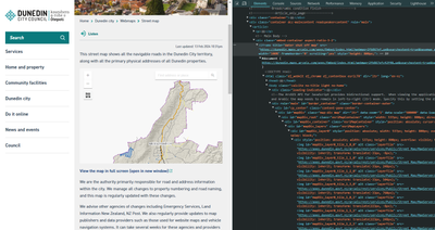

@AshrafAyman6 - Sometimes you can view the inspect the source of the webpage to find the link to the data source. It will need to be a supported data source ArcGIService/WFS/WMS, etc

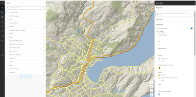

What webpage are you looking at? Example - Assuming it is a ArcGIS service, you can "inspect" the map to reveal some data.

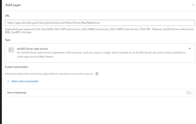

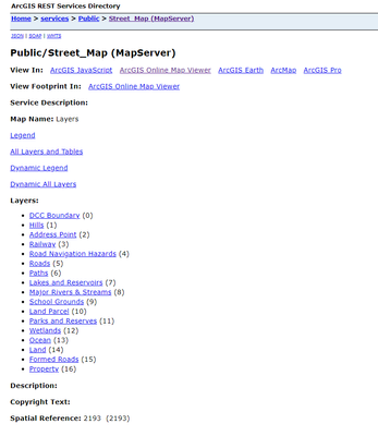

Which tells me the data is coming from https://apps.dunedin.govt.nz/arcgis/rest/services/Public/Street_Map/MapServerYou can then add this data to AGOL by selecting the "Add Data via URL" option.
