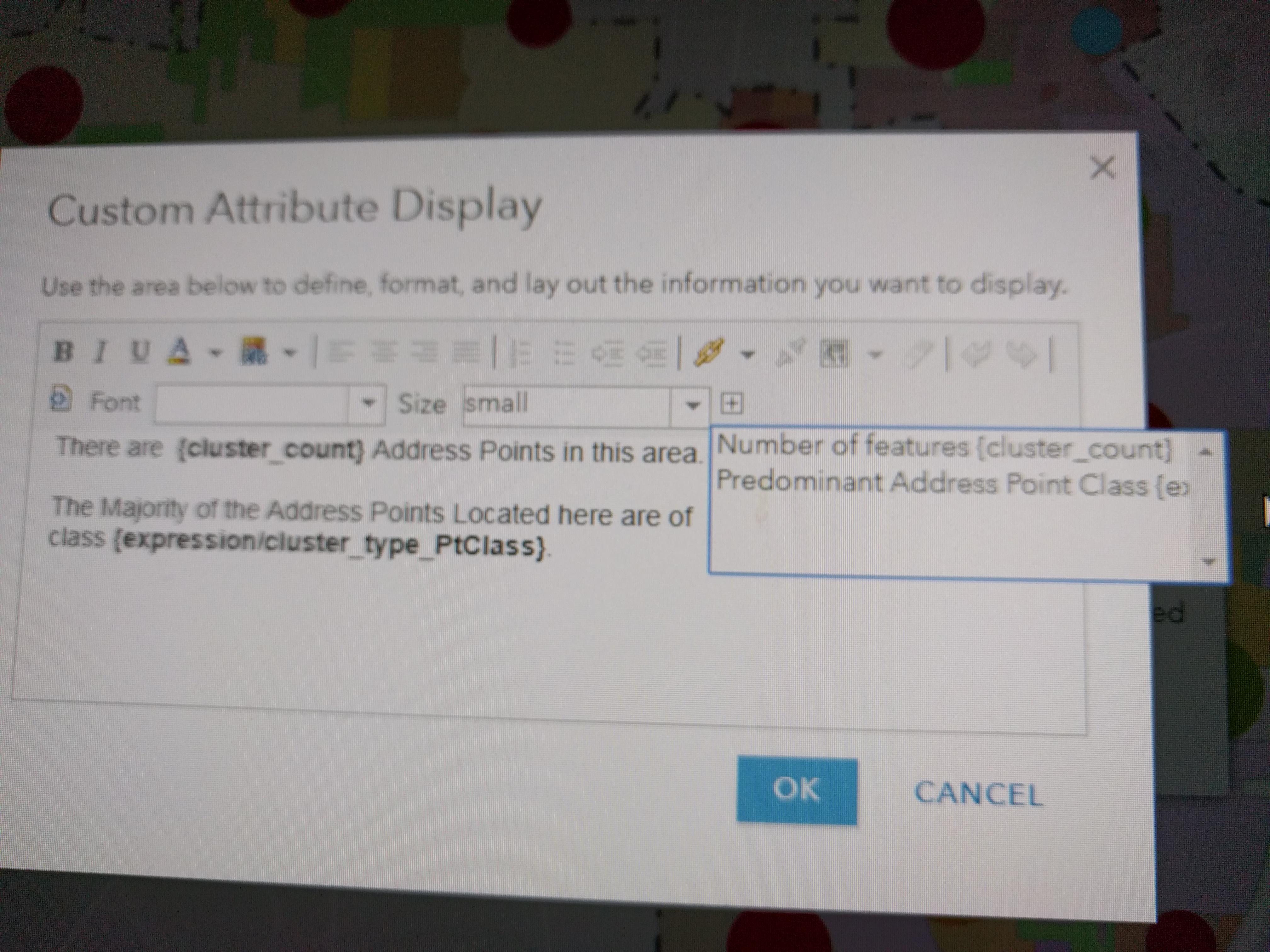

Hello:
Would anyone know of a way to use an Arcade Attribute Expression that was created in the General 'Configure Pop-up' window inside of the 'Configure Clustering Popup' Window Custom Attribute Display? What I am attempting to do is to use an Arcade attribute expression to provide meaningful names for the point classes of some address points. For Example, instead of 'Residential - Single Structure', below. I would like for the class to read 'Residential Structure' or 'House' (See Figure 1). I am able to do this for in the Popups for individual address points. However, I am unable to do this for Popups depicting clusters of address points.
Figure 1
The problem that I am running into is that I am unable to access any of the arcade expressions that I created inside of the General 'Configure Pop-up' Window (See Figure 2).
Figure 2
Please let me know if I can provide any additional information that might help.
Thanks
Nico

Hi Nico Kroes ,
The cluster window does not have the possibility to use Arcade functions to change the pop-up window. However, you can use an Arcade expression for the symbology and change the names as you want them to appear and that will be used in the cluster pop-up window.
Let's take a small example. I have a set of points that I symbolize on a field called CLASE_USO. There are a couple of values that contain the word "ESTRATO":
Which makes the cluster pop-up to appear like this:
If I want the text "ESTRATO" to be replaced by "LEVEL" I can create an expression for the symbology:
This  expression in my case will just have a replace to change the text:
This will change the visualization (the legend actually):
If you go into the configuration of the cluster pop-up you will see that it is using an expression with a strange kong name. This is the expression based on your expression used for the symbology:
The result will like like this:

NicoKroes2
Thanks Xander Bakker‌. This solution worked for my needs. In addition to what you stated above, I added the Replace Functions inside several if statements to ensure that I was changing each point class name was changed exactly to what I needed. Without doing this, I was only able to replace one or two point class names at a time. Please correct me if I am wrong in this assertion.
Thank you for your help with this.
