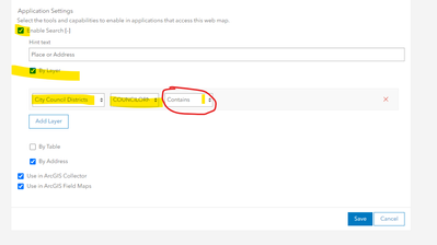

Because you want to have users search the map you are probably going to have to create a web app to allow this - depending on your needs one of the simple instant apps would probably work well. But in your web map go to settings in the detail page and scroll to the bottom and set how you want the map to perform searches, in the screen shot below have set up the web map to allow searching against a city council district layer using the councilor name and the 'contains' parameter so that users can enter partial names and get a pick list of potential matches.

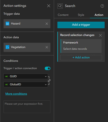

Hi @MDB_GIS - You could achieve this (with a horrible workaround) within ArcGIS ExB Application.
In the Search Widget settings you define a framework to select related records.
In the screenshot below - Vegetation is point feature layer and Hazard is a table related by a relationship class.

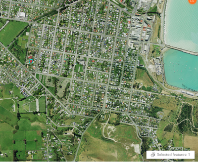

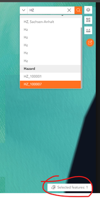

I can search for a Hazard, I can see it and selecting the table record selects the feature layer record.
You then click on the 'magnifying' glass to zoom to the record.

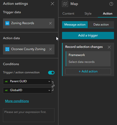

MDB_GIS
Thank you for this post, this is pretty much what I'm looking for. I think I have replicated your steps, however, and the "Selected Features" button does not show up for me. Have I missed something?
The search widget auto-populates, so it sees the table, but for some reason, the option to select just doesn't appear.
