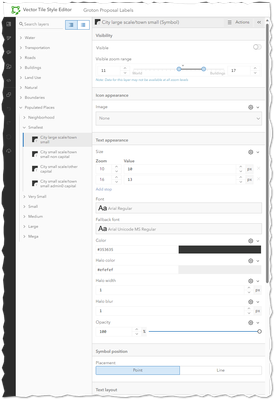

Hi there,
I am using ArcGIS Pro to create a map showing where some survey sites are on a map of NZ. The basemaps have city and town labels which is great because I want some of them to be included. However, when I zoom in and use a print layout from the zoomed in view it includes more place names than I want. Is there a way to set it so only the major cities/towns are included whether you are zoomed in or not?
Thanks!
MicZatorsky_AEC
Try the ArcGIS Vector Tile Style Editor.
Some of the basemaps come with label layers that you can individually add to a map and individually customize using the vector tile style editor. Labels are split into groups by town size, and each has a visible zoom range config:
Find a label layer that's mostly OK, customise it, then use the customised version in ArcGIS Pro the same way you see other basemap label layers being used
