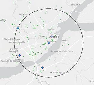

We have a situation that is described below. We are trying to show the competitor information. The map has three layers.
  1. Layer 1: 100 points representing 100 Starbuck Coffee store locations (example)
  2. Layer 2: all the competitors’ coffee shops within 10 km of those 100 Starbuck coffee stores in layer1
  3. We will create a summary layer that describe how many competitors within 10 km of each Starbuck coffee store.
We would like to print each 10KM circle area, the main Starbuck Coffee Store and the competitor coffee shops to one pdf. We will get 100 pdfs for the 100 stores. The sample is like below:
Is there a way that we can quickly create 100 maps with circles and corresponding information?
We are using ArcGIS online. Thank you in advance.
