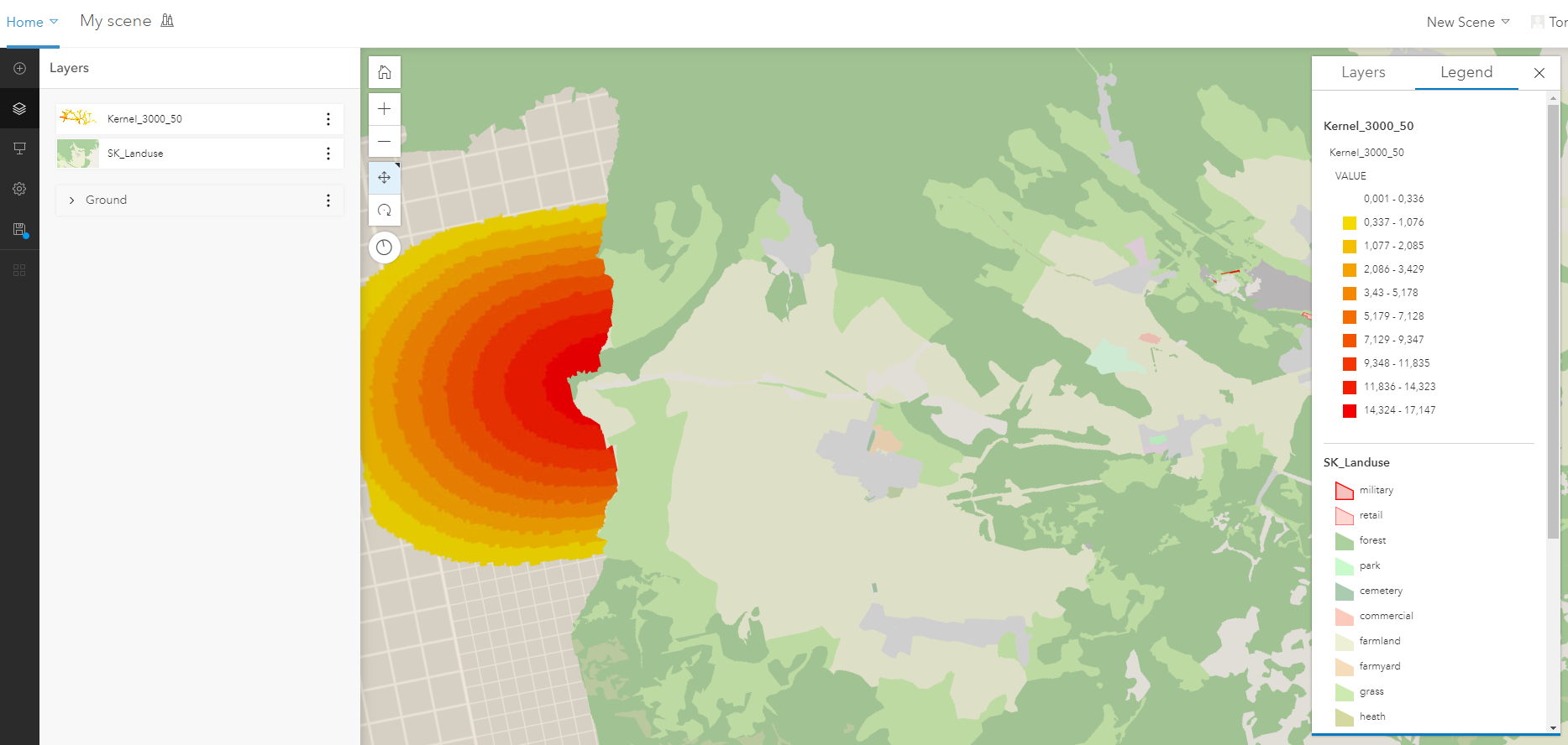

Hello, I'm trying to create 3D web scene with scene viewer and I want to visualize raster layer (which is not supposed to be a basemap) on top of a polygon vector layer. I've set the order of the layers in the "Layers" pane (as shown bellow) but the raster layer is still showing bellow the vector layer.

Hi @TomášAndrš
Regarding the issue you mention in SceneView, it looks like you are trying to render a tiled raster layer on top of a feature layer that has an “on-the-ground” elevation mode.
Please note that the on-the-ground FeatureLayers render on top of all tiled layers (the latter are considered as part of the ground).
For simple cases, it might also work to publish the features as VectorTileLayers. Then, the layer order is respected between all tiled layers (i.e this VectorTileLayer and any WebTileLayers).
Let us know if you have any further questions.

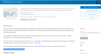

Hello Tomáš, in this case the raster layer is in a different projection system from the basemap and so cannot be added to the Map Viewer.
I would check the basemap item listing and see what the map projection is. Under best metadata practices this should be listed under the description as seen below.

TomášAndrš
Thank you @GreteSoosalu, this has resolved my issue.
(For anyone having the same problem. The TileLayer and the VectorTileLayer also needs to have the same tilling scheme. This might be common knowledge, but I didn't know that, so it might also be helpful for someone else in the future)
