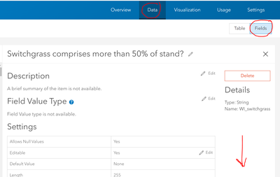

In ArcGIS Online, locate the feature layer associated with the survey and open the item details page. Click on Data > Fields and then click on the field name that has the choice list that you want to edit. Scroll down and click on Edit for the list.

Not sure, how exactly do you do that?
Katie_Clark
MVP Regular Contributor

HA! YES! Thank you 😁
