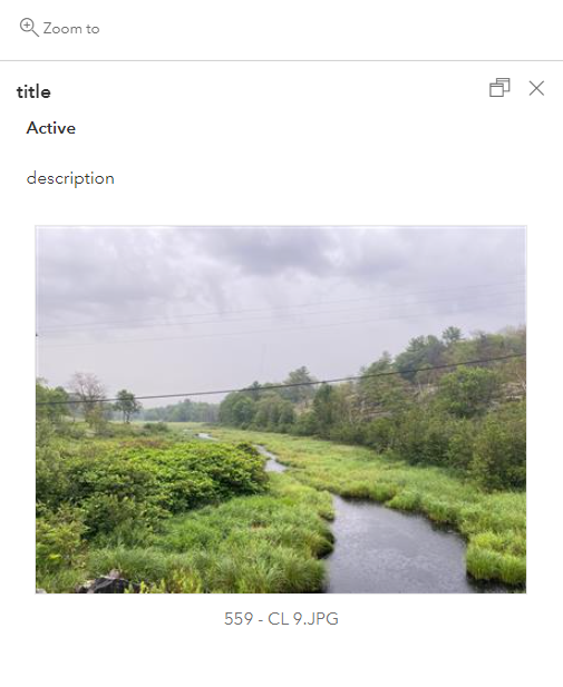

When I add an image attachment to a hosted feature layer and configure the pop up to display the attachment, it automatically puts the file name below the image. Is there a way to remove this file name from the pop up?
In this example is there a way to remove the text "559 - CL 9.JPG" below the picture from the pop up?

This seems to have been resolved.
I've just discovered completely by accident that the filename no longer appears if you add the Attachment content type to your popup in ArcGIS Online (in 'gallery' mode). There's no mention of it in the latest What's New... blog post/documentation (https://www.esri.com/arcgis-blog/products/arcgis-online/announcements/whats-new-arcgis-online-novemb...) so maybe this wasn't deliberate on ESRIs part and might be undone in a future release - who knows!
For now, it seems to be working as desired and the filename is no longer displayed when using the 'gallery' mode (although there is no option to display the filename if you were using that before).
