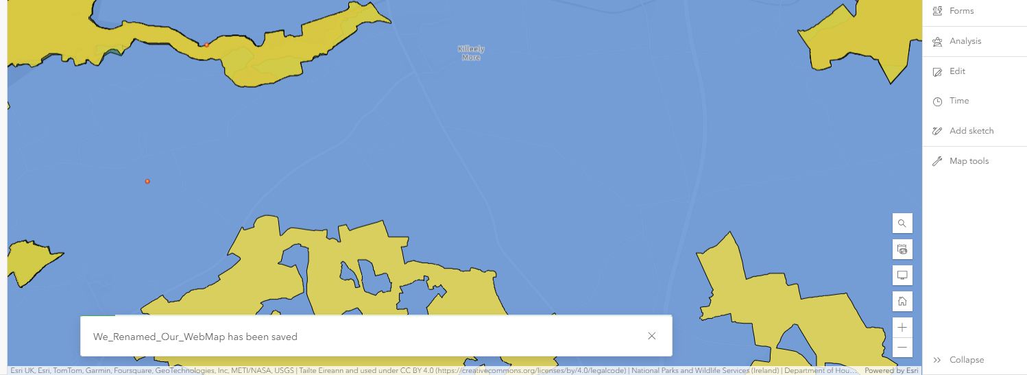

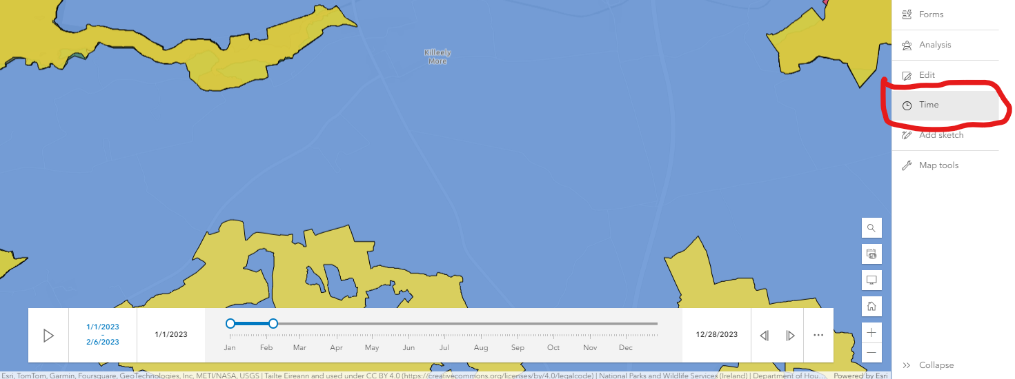

This layer is in my map, when I open the map the time slider shows automatically, I can turn it off by selecting Time on the right and toggle on/off.
If I toggle off and save the map, when I reopen the time slider still appears. I would like it not to, but the option to turn it on when needed.

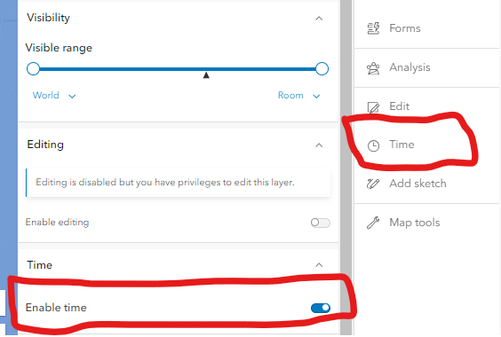

Now, here's what I can do, I can go to the layer properties and see that Enable Time is toggled on, and I can see the Time toggle on the right.

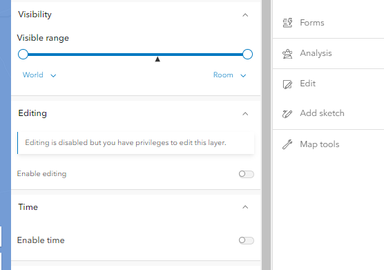

If I toggle off the Enable time for the layer, the Time toggle disappears from the right.
I toggle on Enable Time but do not have the Time toggled on and I save the Map. I want it to open just like this, without the slider but the option to turn on when needed, not the opposite where I have to toggle off upon opening the Map.

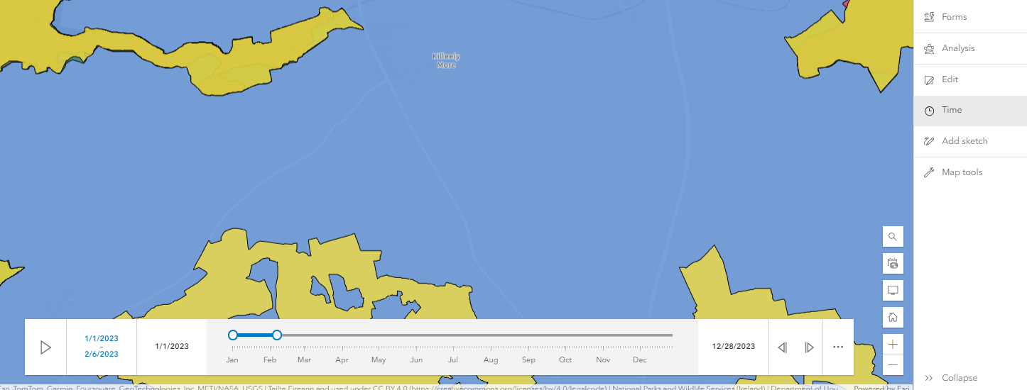

But when I reopen or refresh, the time slider shows.

If the time-enabled layer shows with the time setting as being enabled, disabling the option and saving the map should be honoured so that when you reopen the saved map from your content, the time setting should show as disabled.
I have tested this with a map from the Living Atlas, Bioclimate Projections: (11) Mean Temperature of Coldest Quarter. When I first loaded the layer in the Map Viewer, the time setting was enabled. I disabled the setting and saved the map. I then went back to my Content page and opened the map. This time, the layer loaded with the Time option was disabled:

You have just described what I wrote in the original post. I want to be able to leave Enable Time toggled on in the Layer. This will display the time slider initially, but you can turn the time slider off by clicking Time on the righthand side. Then save the Map, the map has now been saved with the time slider toggled off. When you reopen the Map, or refresh the page, the time slider appears, even though I saved the map with it toggled off, thus, not honoring how I wanted the map state to be saved.
