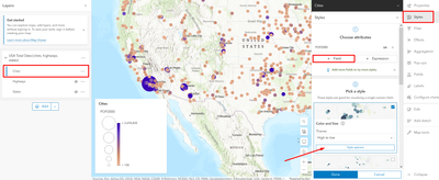

Hi @Jackbigs, yes it is possible to display a map using color and size but you need to have the correct types of variables to apply the style. In this example I have the cities layer selected, then I clicked on Styles. From here I clicked on the + Field button where you can add one or more fields to represent on your map. Once I selected my POP2000 field, I applied the Color and Size style.
You can learn more about what styles are supported and how by viewing the table in this documentation: https://doc.arcgis.com/en/arcgis-online/create-maps/apply-styles-mv.htm
