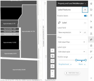

You can use an Arcade expression to add the thousand separator and your additional text. This example uses the Text function and template literals.
`Approximately ${Text($feature["RECORD_AREA_SF"], "#,###")}`

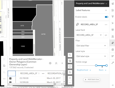

This is what the original looked like. Note that the field already has the thousands separator turned on, which isn't reflected in the unformatted label.

Ahhhh !!  Very nice. Thank you! Have a great day!  - Chuck
