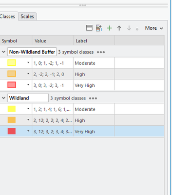

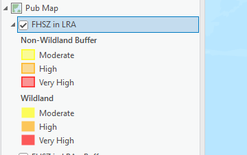

I need this also - I grouped symbols in ArcGIS Pro but when I publish to a feature service and add to Map Viewer (new) it ungroups all the symbols. Esri said there is an enhancement logged - so maybe it will come out end of April 2023.

What a bummer. I found this thread because when I published a layer grouped like this in Pro..

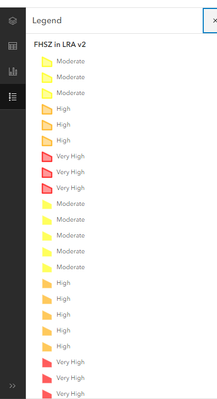

I end up with this in AGOL....
And these are all coded value domains, wo when used in attempts at combination in AGOL it only reads them as the integer fields they are and reverts to arithmetic forms of aggregation.
