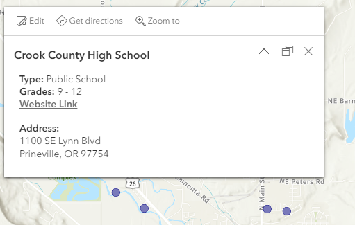

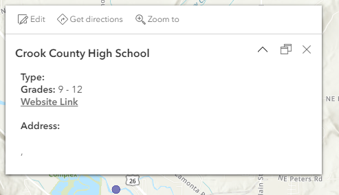

I've put the following Arcade in an Arcade pop-up element for this layer. In the configuration view of the popup the type and address fields return properly but when I click out of the configuration view the type and address views stop returning.
Is there a different way I should be specifying these fields? It seems like there should be a better way than defining all the fields I want to use as variables.

jcarlson
MVP Alum
Hard to say, really. If that's the literal text of your popup, though, don't you need those address fields to be $feature.Site_Address_Line1, etc? Putting the attribute name in brackets doesn't usually work unless you're configuring a text item for your popup. Since you're using an Arcade element, you probably need the full attribute notation.
