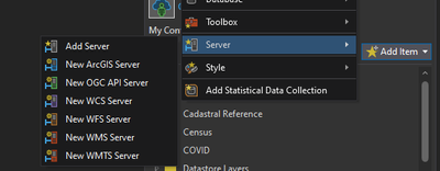

The nearest you can get to that is to go into your Favorites in the catalog and add an ArcGIS Server and add their REST URL.
It's nowhere near as nice as searching for things like in the Portal tab of the catalog, but it's a start. I'd definitely upvote the idea if you post it, though!
