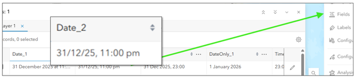

Hi @DavidChanIWC
Yes, you can display the date in the table using the format you describe. First, make sure the settings (in My Settings) are set to Australia - Australia‎. Then in Map Viewer you can format for the date field in the Fields pane and that will persist across both pop-ups and tables:

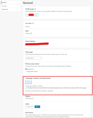

@DavidChanIWC  - There are organization settings and there are user specific settings.
Try changing them in the user profile settings.
It took us a while to realize this.
Hope this helps.

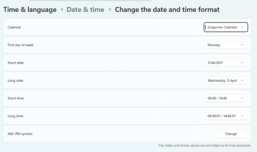

@DavidChanIWC
Check your computer's locale settings.
Sometimes the US manages to creep into unwanted spots after a Windows update.
I once had these settings changed unknowingly and it confused me a lot as nothing in Pro / AGOL was set incorrectly.
