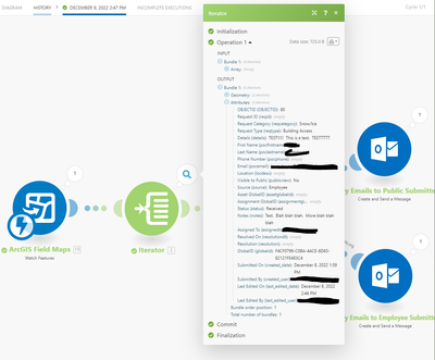

This is what comes from the iterator:
jcarlson
MVP Esteemed Contributor

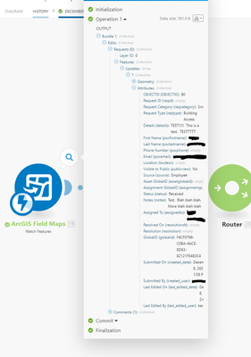

Oh, I see! You're using the Field Maps integration, which I think is just grabbing the form itself. I was thinking of a feature service webook: Webhooks - Payloads (Feature Service)—ArcGIS REST APIs | ArcGIS Developers
That uses the Extract Changes capability. I've only minimally worked with it, and have not dug into the new capabilities at 11.0, but you ought to be able to see specific changes that way.

This is the output of the Watch Feature edits:
