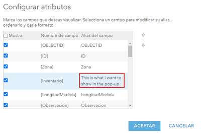

Hi @ZachBodenner ,
There is no need to use Arcade in this case. Just go into the configure pop-up option of the layer, there you will find the option "configure attributes" and in the window that appears you can change the alias of the field name:
