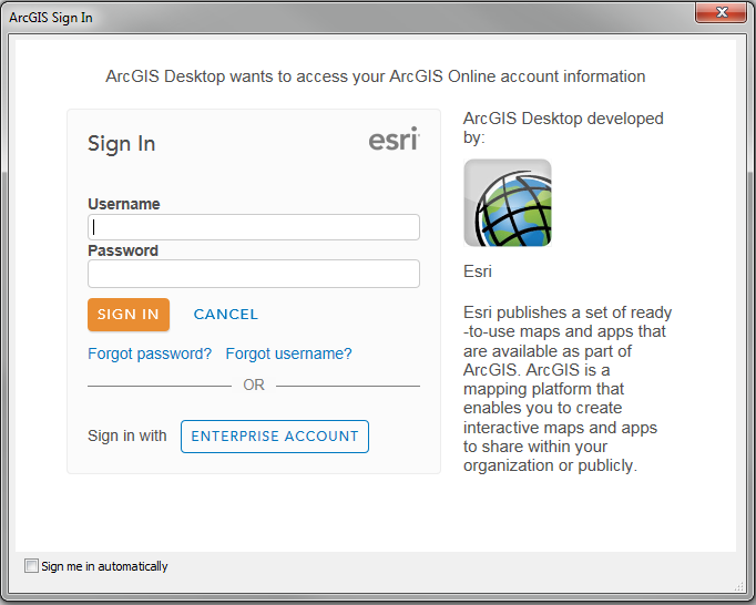

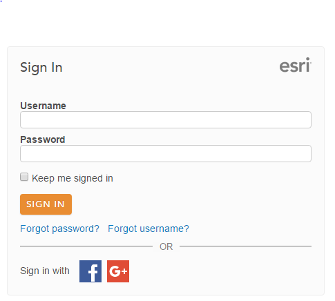

I created an AGOL account using the Google credentials. When I try to sign in from an internet browser, I am able to sign in. I use the Google+ button.
When I try to sign in through ArcMap, however, this option is not available.
I want to sign in to my AGOL account from ArcMap in order to publish some of the data that I have as a service in my AGOL account. Since I am unable to log in, I am unable to publish the data.
I have tried signing in using my full gmail email address. Also I have tried changing the password or sending a reminder of the username. I have verified that the username and password that I am using are correct.
How do I log into AGOL through ArcMap to publish a service?
Thank you for your assistance.

Thank you for your response. I am currently logged into my moremountainbiketrails account. I registered it with GeoNet as well. I tried logging into AGOL in the browser with my username and password but that did not work. I also tried it with @gmail.com but that did not work either. The only way to log into the browser is through the Google+ button. If I am already logged into my Google account, then it verifies the username and password without any additional entries. I tried these same options from the pop-up in ArcMap but they did not work there either. The pop-up in ArcMap does not include a Google+ option, which is why I do not know how to log in there.
