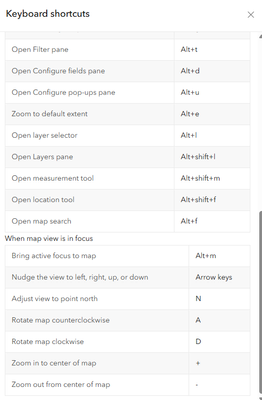

I'm not sure if there's a way to enter a specific angle, but I did want to share that you can use the keyboard shortcuts A and D when the map view is in focus to rotate the map. Perhaps that would be easier than dragging with a mouse?
Best,
Katie
