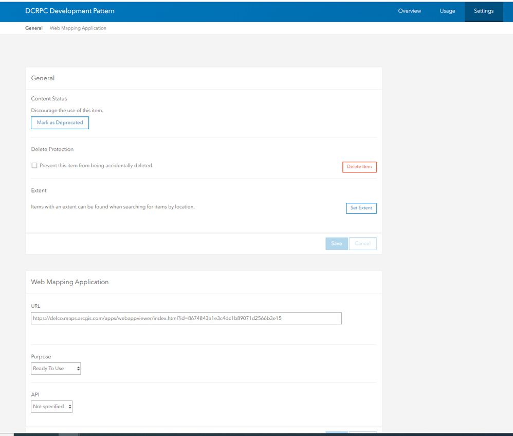

Do you know where can I find those options ?  I cannot see this in my web app setting page as the following.
Thanks.
Da-Wei

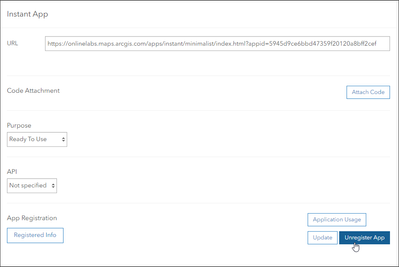

If the app is registered, you will find that in Settings > App registration:
EvanHayes
Was solution ever found for this?  I recently ran into the same issue with an application I use frequently.  Out of nowhere, somehow it now has the OAuth 2.0 lock, and I don't see those settings shown above to remove it.
