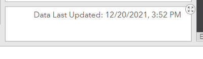

What I'm trying to do is show the Last Edit Date for a feature in a Dashboard. I can see the last edit date in the REST URL but I'm not sure how to extract it in a format that can be posted to an Element in a Dashboard. I understand that Dashboards have the ability to say when they were last updated but I'm interested in reporting when the feature, that the dashboard is pointing to, was last updated. It can often be misleading when the dashboard says it was updated seconds ago but the data hasn't been updated for hours.
Seems like it should be simple enough with a custom URL, or Arcade, but I can't figure it out.

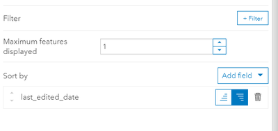

We use a List element that is set to display one feature, sorted by last edited date descending, to show when the feature layer was last updated.
See it live at: https://maps.cookcountyil.gov/medexamcovid19/
CalebAnderson
Good suggestion thanks. We looked at doing this but the current data set we're uploading to AGOL does not have these fields. We could add them, of course, but this would force a few changes upstream that I was hoping to avoid. Also, there are often instances where the dataset does get updated, but there are no changes (we upload the data to AGOL every 10 minutes). Either way, going to keep this in my back pocket thanks.
