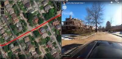

  1. GeoTube for ArcGIS. This tool seamlessly integrates a YouTube video player directly within ArcGIS Experience Builder.  GeoTube allows users to watch YouTube videos (2D or 360) within the web map while simultaneously displaying the associated location, visualizing the video path, and observing the playback location as features on the map. This enhanced user interface provides a comprehensive and intuitive understanding of the spatial relationship between videos and their corresponding geographic locations. You can learn more about GeoTube here: https://www.nodeology.net/geotube/.ClarkSelby_0-1688576872977.jpegVisualize in YouTube. Analyze in ArcGIS.

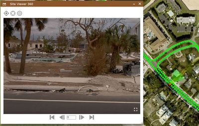

  2. SiteViewer 360 for ArcGIS: By capturing your site with a 360 camera, you can immerse yourself in panoramic views, enabling detailed analysis and exploration from every angle. ArcGIS Online 360 demos are available, featuring imagery of Hurricane Ian, Pittsburgh Steps, and Rails-to-Trails, at the bottom of this page:  https://www.nodeology.net/site-viewer-360-for-arcgis/.  ClarkSelby_1-1688576872981.jpegHurricane Ian 360 imagery
