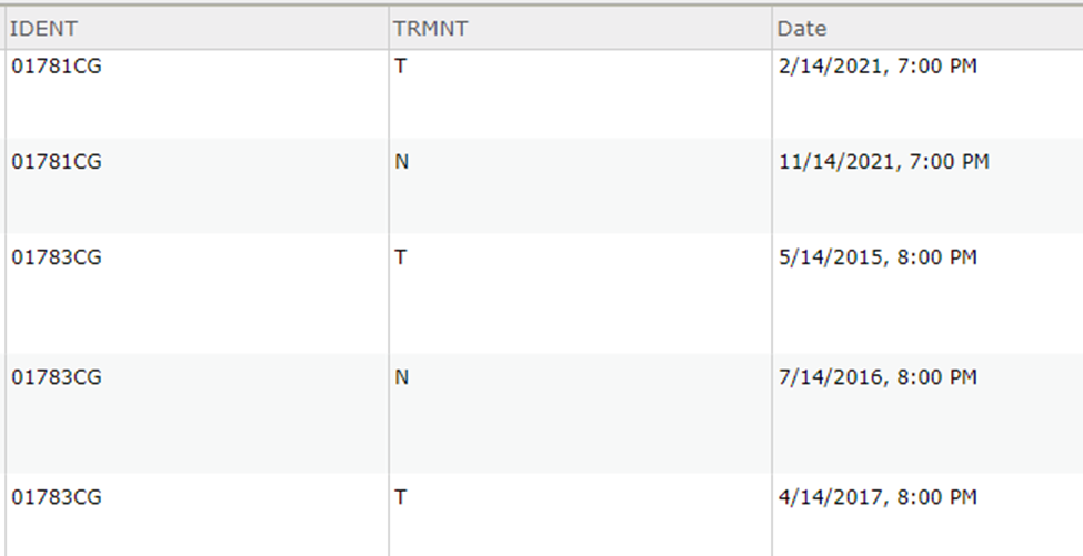

Hello, I have a set of points with unique identifiers (IDENT), and for each point, different treatments (TRMNT) were applied on different dates.
Here is the structure of my data:
I am trying to visualize all the information for each point, including the treatment and date, using the results of the FeatureSetByRelationshipName function. I found a solution on the Esri Community website in this post: "Displaying all information from a FeatureSetByRelationshipName."

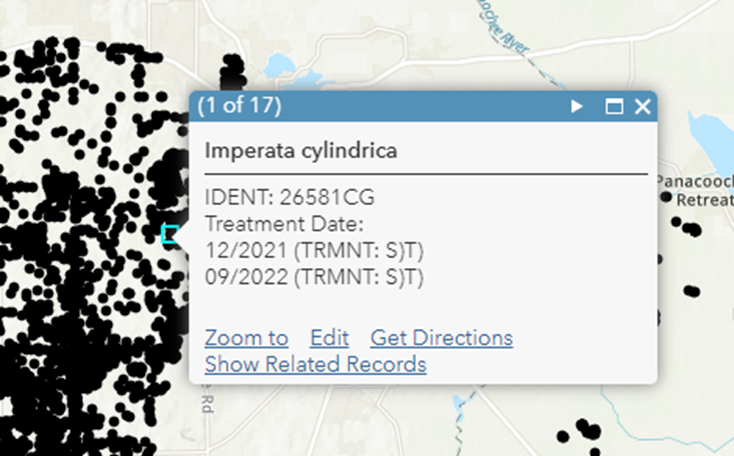

Following the instructions provided in that post, I managed to display the dates successfully. However, I encountered an issue where the correct information for the treatments (TRMNT) is not displayed for each date. Instead, all treatments are being shown for each date. I attempted to solve this problem by implementing a loop to select the appropriate treatment information for each date, but unfortunately, it did not work.
The resulting pop-up display appears as follows:
Would you please help me?
