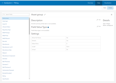

I downloaded the As-Built solution on Esri and I am trying to add a few more vales to the Fittings layer  Asset Group but it's not allowing me to add new values. Is this normal and are there any workarounds?

Edits work great on my end but I can't seem to add additional values to the Asset Group field for some reason. If I open the Fittings layers in ArcGIS Pro and click on the Asset Group dropdown there are pre-populated values.

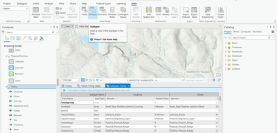

Ah I see, this is because the layer comes with subtypes enabled. You will need access to the underlying feature geodatabase to remove or make edits to this which is not possible with the layer as is from ArcGIS Solutions.
I would recommend exporting the layer from ArcGIS Online then in ArcGIS Pro you can load the exported layer and make changes via the subtypes via the Data tab
Once this is sorted you can publish or overwrite the previous layer.
