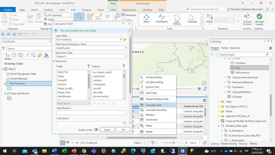

2. Calculate Field (Data Management) - Find object A and copy attributes from B to A
Calculates the values of a field for a feature class, feature layer, or raster. See in following link:
https://pro.arcgis.com/en/pro-app/latest/tool-reference/data-management/calculate-field.htm
See the following image:
