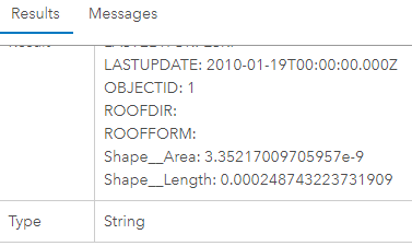

JohannesLindner
MVP Alum
Something like this?
var attributes = Dictionary(Text($feature))["attributes"]
var popup_lines = []
for(var a in attributes) {
    var line = `${a}: ${attributes[a]}`
    Push(popup_lines, line)
return Concatenate(popup_lines, TextFormatting.NewLine)
Have a great day!
Johannes
