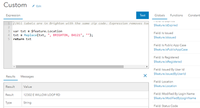

I stumbled upon this thread when I was looking to remove part of a label from a feature field in a webmap. Here's what I ended up with:
//All labels are in Brighton with the same zip code. Expression removes town and zip code
var txt = $feature.Location
txt = Replace(txt, ", BRIGHTON, 84121", "");
return txt
Thanks!
