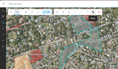

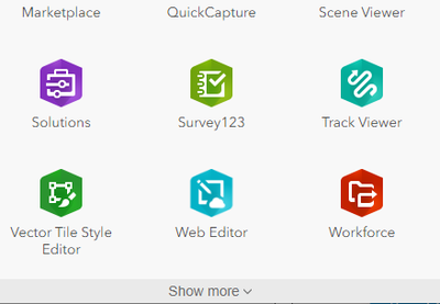

Hey @ElliottD take a look at the new ArcGIS Web Editor, it will allow you to do this:
Worked for me,
Cheers
Keiran
Worked for me,
Cheers
Keiran

hi @ElliottD, @Kbray_gis_ is correct, ArcGIS Web Editor launched in June of 2024 and one of the exciting features to come along with it is merging features! See our doc here: https://doc.arcgis.com/en/web-editor/latest/create-and-edit/merge-features.htm or visit our community page for more info https://community.esri.com/t5/arcgis-web-editor/ct-p/arcgis-web-editor
ElliottD
Just what I was hoping for! Thank you @Kbray_gis_ and @bbollin . Did not know about web editor.
