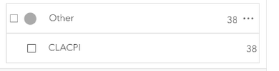

I couldn't reproduce the issue but  noticed under the Types style you have a count of 38 features in other and with Other not enabled to display in the map. The filter you could be selecting is on a different field but could be for one of those Other values under Types which makes it seem like nothing is being displayed.
