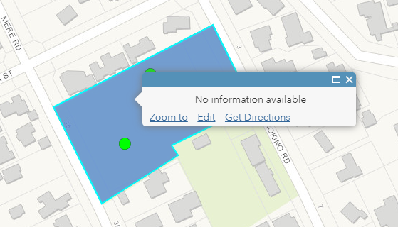

I've tried this Top function for a popup.
I get results within the attribute expression builder test.
I have the displaying a description from one field (the expression).
However the popup is showing no information available.  Because it is returning as a table, does this need to be inputted into the popup in a different way?  Or do I need to be calling out the couple of fields I am actually interested in from the table?

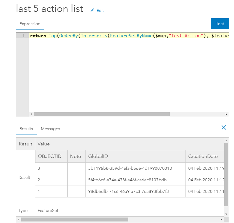

XanderBakker
Esri Esteemed Contributor
Hi Naomi Begg ,
In your screenshot (which unfortunately only shows part of the expression used) you notice that the return type is a featureset and a featureset cannot be visualized in the pop-up. To create a readable result, you will have to loop through the featureset and create a multiline string with the information of the features that you want to show.
Something like this:
var fs = Top(OrderBy(Intersects(FeatureSetByName(...
var result = "";
for (var f in fs) {
    if (result == "") {
        result = Text(f.CreationDate, ' - (Y/MM/DD) ') + ": " + f.Activity;
    } else {
        result += TextFormatting.NewLine + Text(f.CreationDate, ' - (Y/MM/DD) ') + ": " + f.Activity;
return result;
